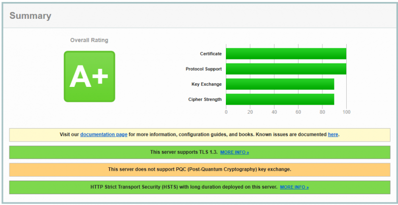

Then restart nginx with systemctl restart nginx and test again by clicking “Clear Cache”.
TLS 1.3 should now be supported.

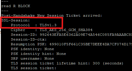

You can also use the command line to check whether TLS 1.3 is enabled:
echo "Q" | openssl s_client -connect localhost:443 -tls1_3
A message containing Protocol : TLSv1.3 should then appear, such as:
