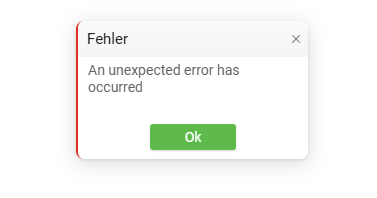

  • "An unexpected error has occurred" Grommunio Web Search

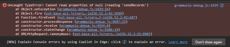

      Hi crpd,
      the admin Dashboard shows no abnormal. I can not login to the user panel, here I get the error "cannot connect to Gromox".
      Here the output of the commands:

        Using the WebUI, I cannot search email and calendars, I only get "An unexpected error has occurred"
        Do the http logs show any errors? tail /var/log/nginx/*.log -f
        Any errors in journalctl -f ?

        Ich kann den Fehler bei mir nun auch reproduzieren :---).
        Mehr gibts noch nicht..
        Hmm.. so i can still break my outlook by doing silly searches for 5+ mails but my grommunio-index is healty again even thou i had a short nasty error which at first looked like hell broke loos.. 😱 .
