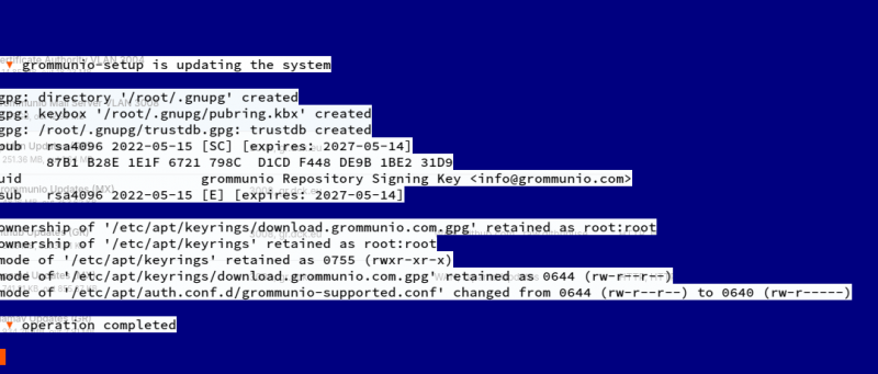

There are still some issue on Debian 13. Sometimes it won't create the folders and files in /etc/ and sometimes some packages are missing / they simple won't be installed. Then you restore the snapshot and repeat the same procedure again and you get a different result. Is there a parameter to create a debug log when running Grommunio-Setup?
Edit 1:
Sometimes it gets stuck like this:
After more than one hour I killed the script and I have run it again (ofc I had to remove the grommunio sources that already were added by the script). Then it has worked without any problems. Weird.
