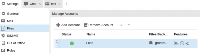

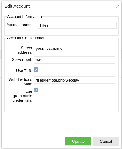

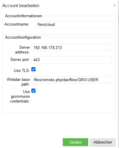

I have now tested to create several accounts with all my nativ Nextcloud and Owncloud installations. With none of them do I get a green dot when I create an account to access via WebDAV. From this point of view, it seems to me that this is a problem in the WebAPP. If, on the other hand, I establish a direct WebDAV connection to my data servers, it works perfectly.
